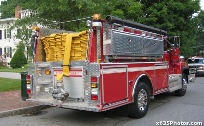

We do both, depending on the situation, either drop ponds and do shuttles with mutual aid tankers or lay from the scene to the water source or vise versa, on our E-1 we have 4,000' of 5" hose, we also have to 2 manifolds we drop at certain points (every 1,500 feet, or a incline ect).

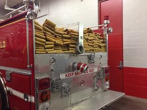

Here is a close up of my depts (Litchfield,CT) Eng 1, 1978 Oren / Peterbilt 300 Gallon tank with a 1500 gpm pump, off the rear is a split hose bed with 2-2000' sections of 5" hose (4,000' total).
Here's the back step of it....

This a couple mins to set it up and flow water but once its flowing theres no interuptions (usually) no waititng for tankers to fill, no waitiing for tankers to dump, ect. Packing the hose...ehh part of the job.
