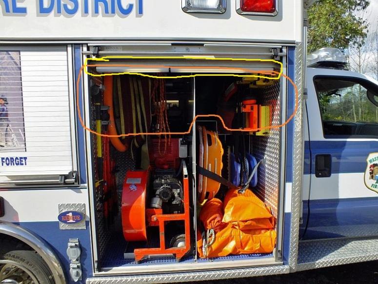

there are 2 SCBA, drivers side front compartment there currently is a PPV fan, hand tools, above there are a few ladder belts, rescue collar for water/ice rescue, four reels of water rope, four throw bags and four cold water rescue suits, we do not have any low or high angle rope or equipment at this point, definitely lacking in that area and an area that obviously needs improvement, we had just spoke about that very fact over the weekend and getting updated training there, there are very few of us that has attended any type of rope rescue training.
The generator and long boards and stoke baskets are in this compartment low, my thought was to have slide out trays installed over the generator area and long boards which would make better use of that dead area, see the area circles in orange. Also replacing the lightboxes with smaller more efficient LED flashlights as well would free up the front wall of this compartment. The compartment lighting is at the top of the opening to each compartment which takes up about 4" of height, an upgrade to LED strip lighting inside the inner tracks of the doors would also help too (lights circles in yellow) *Note* the PPV fan will be moved soon to our tanker as soon as the small electric fan returns from the powder coat shop.
Edited by markmets415
Why do you have to carry any fan on the unit? Your a light rescue, not a heavy or fire support truck. I love the Amkus Hydraulic set-up and wouldn't change a thing. I can guarantee your tools mounts are in great shape. Just check for any cracks in the welds and have then re-welded if needed. I also noted 2 SCBA's in the right rear compartment and 1 in a bag on the driver rear????? Do you carry any Air Tools? I would also re-look at those FERNO what you might call STOKES Baskets. They really aren't STOKES Baskets for rope rescue. They are called Carrying Baskets. Not designed for rope work. Look at the information that comes with the baskets. Has to do with the frame of the basket. Not WELDED. Re-place with JUNKIN STOKES BASKETS. Junkin Stokes can also handle the weight of those OBESE PATIENTS. Check the ratings.
The reason for the fan is we've down sized our apparatus and this unit is in fact a support vehicle at times, last spring we had two Engines and are down to one, which will be the new CAFS pumper in the other thread on here. With that said the rescue runs on CO calls, thus the meter and SCBA so there have been occasions that this was all was needed for a CO call and with the fan we can provide ventilation if needed, also there was room for the small box fan so why not place it where it can be used instead of leaving in the closet at the station because of the lost storage space with the reduction of the one engine. Where you see the current large gas PPV fan is where all the water rope is usually stored, the small box fan is stored on the top shelve in the center over the wheel compartment, again until the new engine gets here (hopefully tomorrow) some items have been moved around.

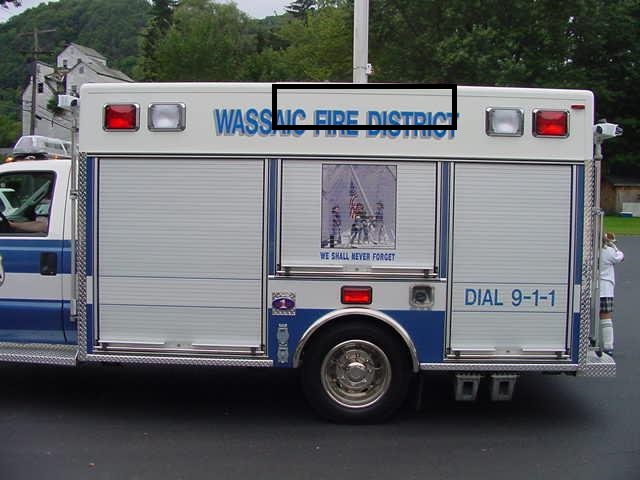

The light tower is nested directly over the center compartment between the second A in Wassaic and the T at the end of District, (see photo below outlined in black). There are extra bottles carried in the tilt out box behind the SCBA but the day I took the photos the Lieutenant had them off to record the bottle info from, that compartment as stated will most likely be reworked and made higher and the SCBA most likely moved to another location, there looks to be ample space on the passengers side to make a wheel well compartment to hold the spare bottles or other things such as flares, etc. There is a tool regulator and hose with the air hammer.
