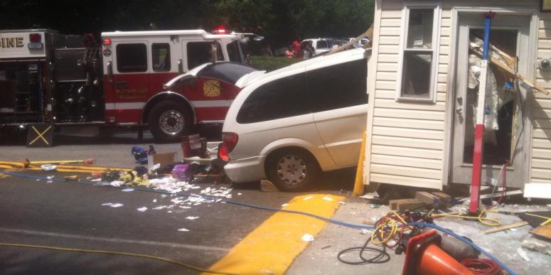

Engine 829 (Silver Hills), Rescue-Engine 827 (Morningside), Medic 829, Ambulance 829, Battalion Chief 883 and the Southern EMS Duty Officer were dispatched to the 3400 block of Curtis drive for a reported PIA with entrapment. E829 was first due and confirmed that a minivan had driven into a guard shack and that the security guard was pinned under the van. RE-827 arrived as the first due special service. Rescue Squad 842 was also requested as part of the County Technical Rescue Team.

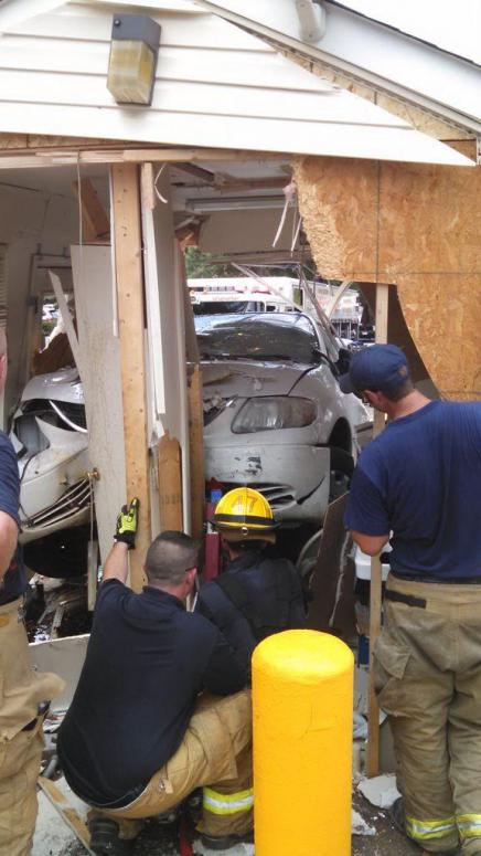

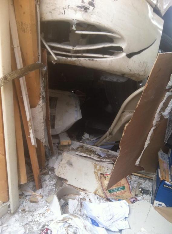

Our initial plan (not being able to see the scene) was to use a Hurst spreader plate to lift the car off the guard and drag him out (this worked for the company a few months ago when a PGPD Officer was trapped under a car on the highway.) Upon arriving we realized the security guard was not completely pinned by the car, an air conditioning unit and filing cabinet had created a small void space that held the car up and protected him from being completely crushed. We also realized we had no room to use the spreaders and our plan became to turn the windows into doors on the "B" and "D" sides of the shack (assuming the van entered in side "A") and then use airbags to lift the vehicle off the patient and let the medics drag him out of the "C" side that was non-load bearing. RS442 arrived and shored the "D" side with the Rescue-42 jack system, and then ultimately it was decided to use another Rescue-42 jack to lift the car off the patient. Patient transported with serious but non-life threatening injuries.

View from the D-Side
View from the C-Side
View of the void space created by the A/C unit and the filing cabinet.
