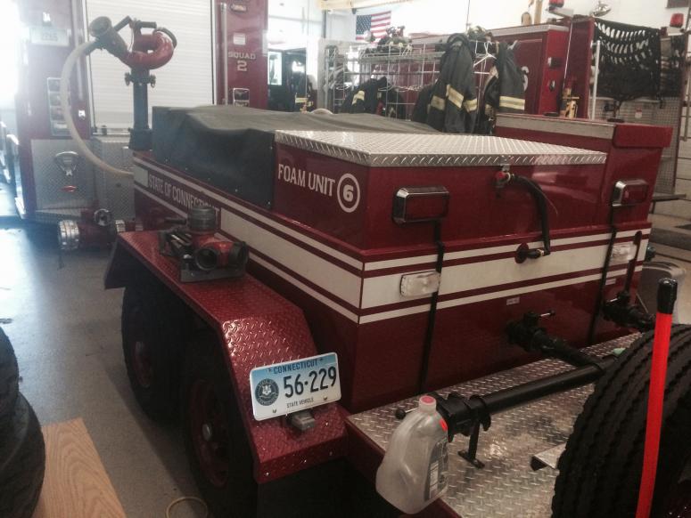

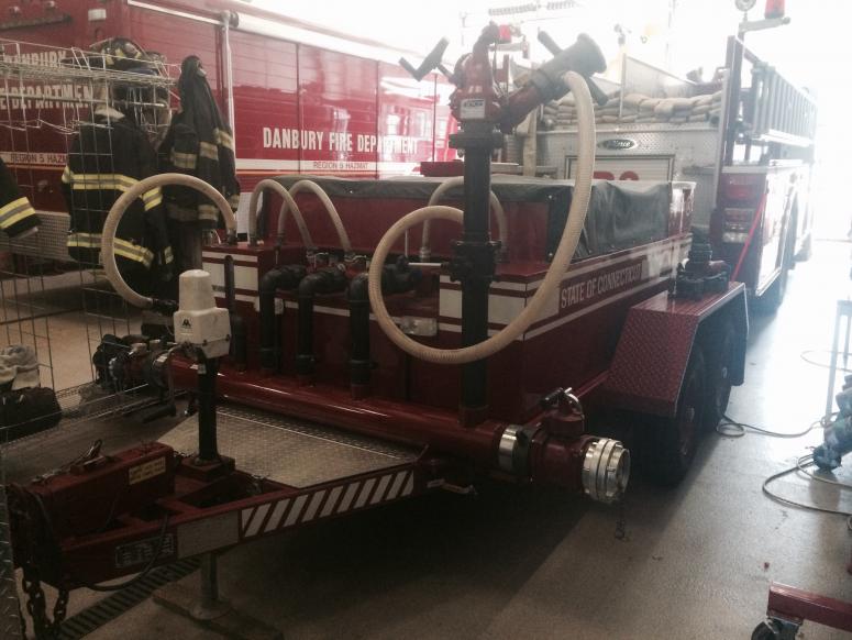

Not in Westchester county but the City of Danbury Fire Department operates a State of CT owned foam trailer. It is a 500 gallon trailer with a master stream, multiple hand lines, on board transfer pump, and many connections. The trailer carries 1/3% Universal Gold and is available for mutual aid. It is assigned to Engine 26 which is the firehouse across from the Danbury Fair Mall. It is staffed 24/7 and is always ready to respond. It was thought of being called during yesterday's fire in Thornwood.

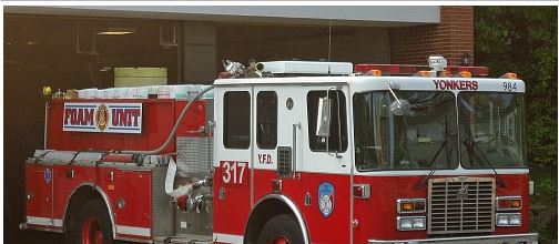

Yonkers FD has its Foam Unit housed at Station 13 and is run as part of YFD's Special Operations Department, supported by the crew of Engine 313 and Ladder 73. YFD has used this apparatus on a few occasions over the years.

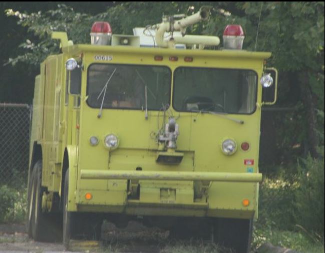

Mount Vernon FD's Foam Unit, I believe, hasn't existed in years. When it was "last in service" FDMV was running it, using a converted 1967 Mack C Rig (Former Engine 6), until FDMV disbanded its Foam Unit. There was 1 attempt of reviving the FDMV Foam Rig, when they obtained the Old Westchester County Airport Fire Rig (See Photo), but sadly, that rig sat in the back of Station 2, rusting, for a number of years (I don't think it is still back there), rather than fixing it back up and having it as their Foam Unit (You would think, with all of the businesses down in the Old "Oil City" area of Mount Vernon, there would be a need for such a rig.

I used to drive that ARFF Truck.
Old Airport 7.

What foam does the Yonkers "foam unit" operate with?
The Foam Unit carries a supply of AFFF in 5 gallon containers and has Master Stream Foam Delivery equipment. It responds with E313 and L73 whose crews are trained in its deployment.

Chief, just curious as to the choice of the AFFF? I'm no foam expert but isn't AR-AFFF a more all around "general purpose" agent and wouldn't it give you the all around best bang for your buck for different scenarios or situations. I am not sure what is in the DES trailer but I know Danbury and the State of CT use AR-AFFF in their trailers.
It looks like the Yonkers foam unit is a former engine. Does it have an on board direct foam induction system? Or are you using foam eductors in the 5 gallon buckets?

Airport 7 was first given to Port Chester as we are first due to the airport but with no place to kept it it was turned down . Then we said that we will man it if it was kept at the airport but they wanted it gone. Then off to the Vern then 4 months ago it was cut up for scrap

It is Alcohol-Resistant AFFF. There is no on-board induction system. A 2 1/2" input/ 2 1/2" output eductor is used along with a large bucket that the 5 gallon pails are poured into. There is a 2 1/2" coupling foam playpipe for delivery.
It isn't fancy but it has been used successfully on many occasions.
