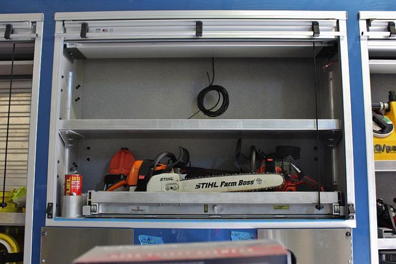

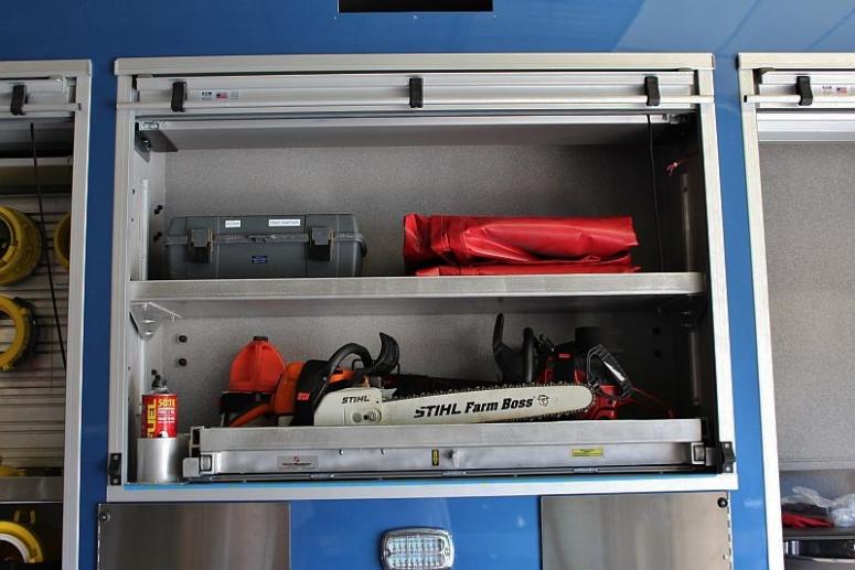

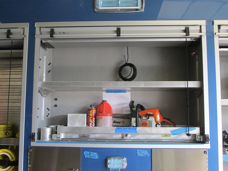

Tilt down shelf showing the layout with chain saw, the vent saw with be on the shelf as well just mounted the opposite way of the chain saw.

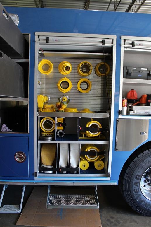

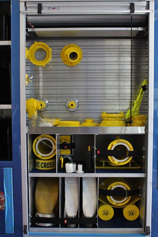

Adding more items to the front strainer compartment, the upper part of the compartment will have all three sides of pac trac for the various adaptors, the Engine has all yellow colored adaptors/strainers and suction ends, we started to color code our apparatus when we purchased the BRAT in 2009

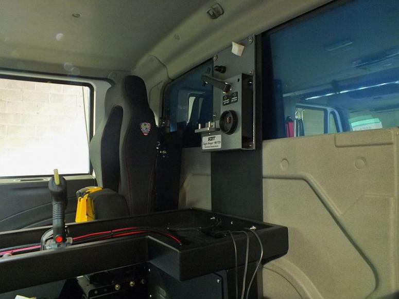

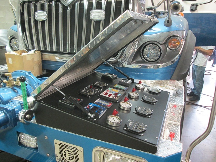

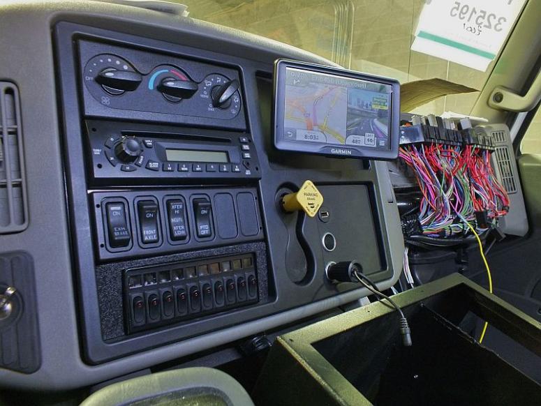

Part of the console area with two cigarette 110 plugs and a USB port and also showing the GPS which also function as the monitor for the back-up camera and the 10 switch panel for the flashing type lights

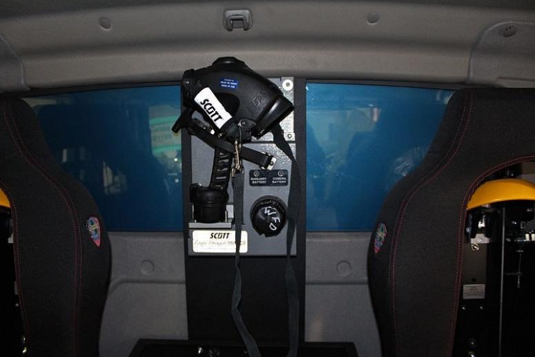

The charger unit for the Scott TIC

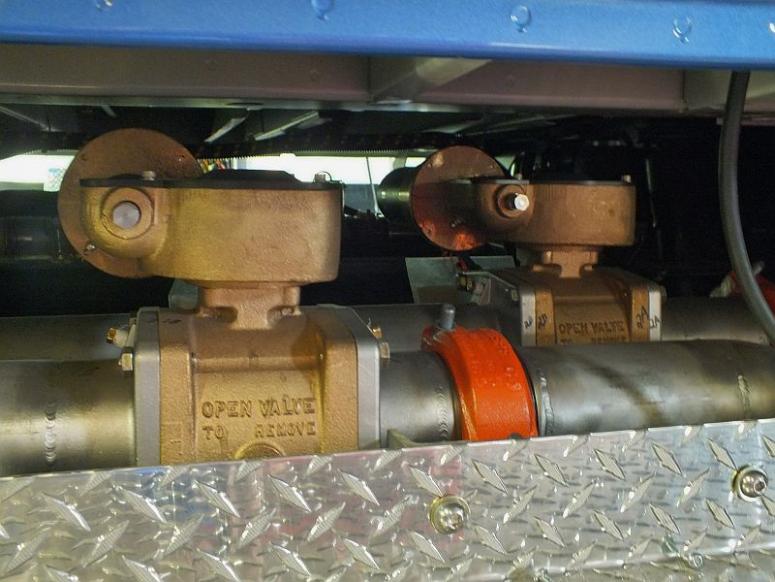

The electronic valves for the CAFS speed lays mounted under the cab
A clearer shot of the front of the tool board

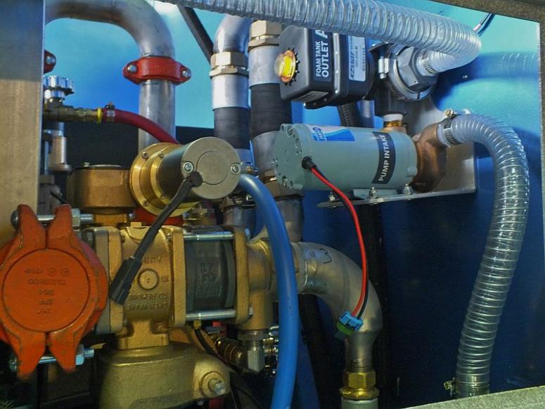

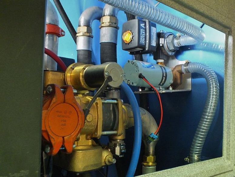

The CAFS appliance and the EZ fill foam unit

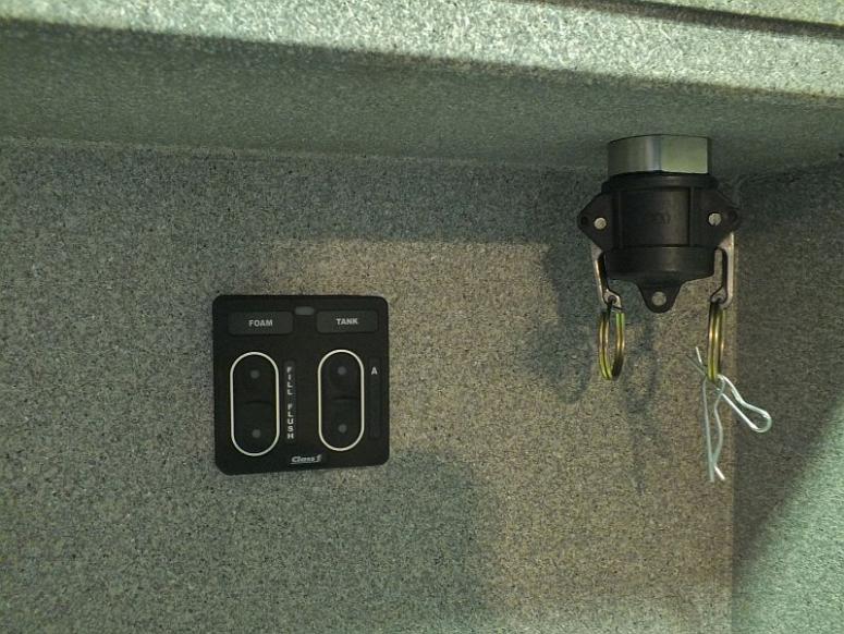

The controls and hook-up for the foam EZ-fill unit
Piping completed for the speed lays

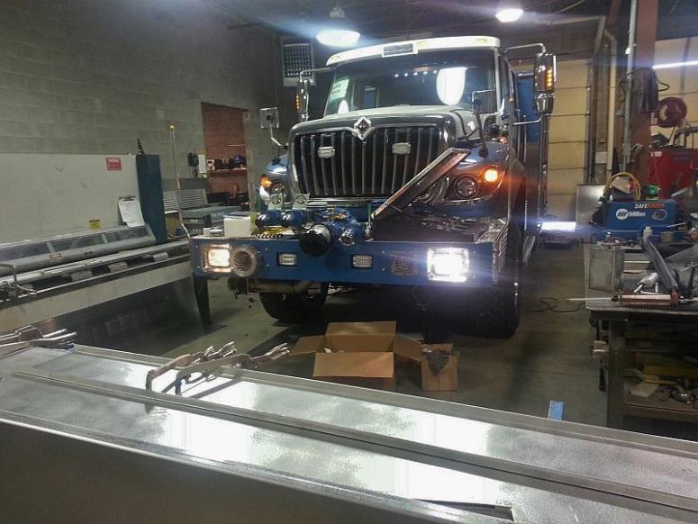

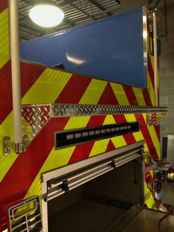

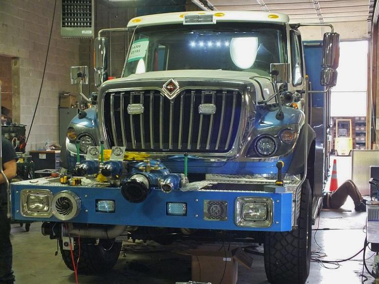

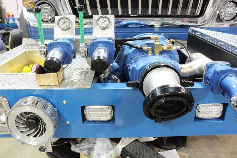

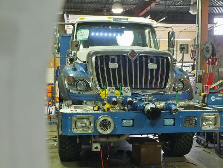

A few more shots of the front, the pump panel was off as it was out to paint,

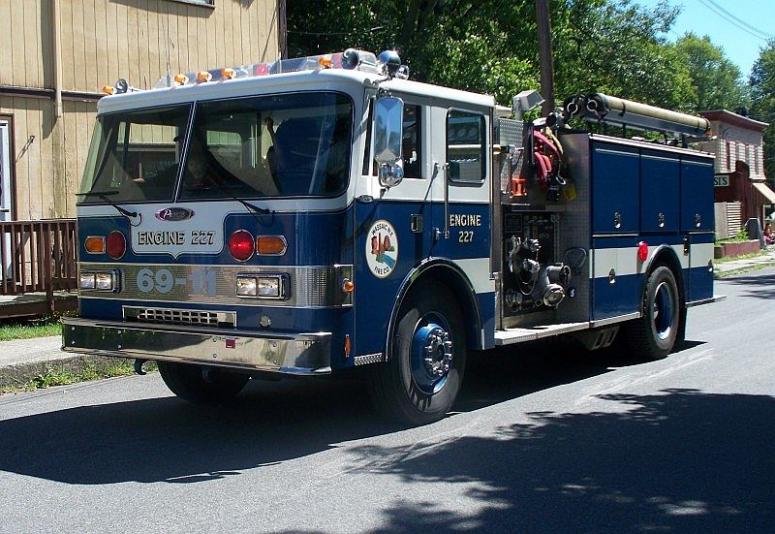

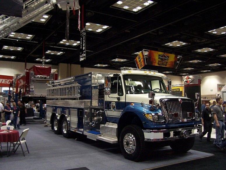

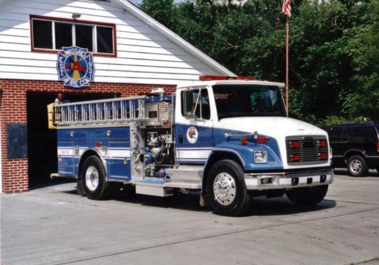

Back in 1988 while attending the NYS show at the old Concord Resort Hotel we came across an Engine that was built by Pierce for Peru, NY, an upstate FD that was painted Bright Regatta Blue or as we called it Pepsi Blue and our crew that was there that day really thought the Engine was very sharp, I took several pictures of it that day. After we returned and knowing that our 1974 tanker was out at Pierce for a refurbish we decided to share the photos with the members at the next monthly meeting and the membership voted to have our Tanker painted the same color, no other reason than that, the rest of the purchases after that have been the blue/white scheme. Here is the engine from Peru are our vehicles that followed (some of the photos are older and not the greatest)
The Peru engine that got it started

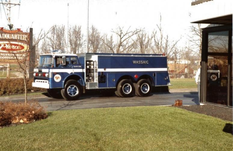

Our Tanker that was refurbished by Pierce in 1988 and first blue vehicle (Retired when new tanker purchased in 2007)
1989 Pierce Dash (retired)
The Dash on scene
1997 Pierce (Went out of service this week as a trade in on the new Engine

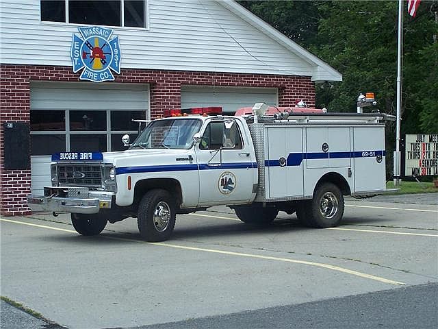

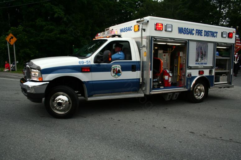

Rescue One light rescue 69-51 (photo courtesy of Ed Harvey)

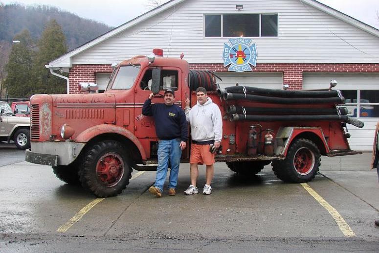

The 1949 FWD we rescued a few years ago, the SIGNMAN and myself the day we brought her back home

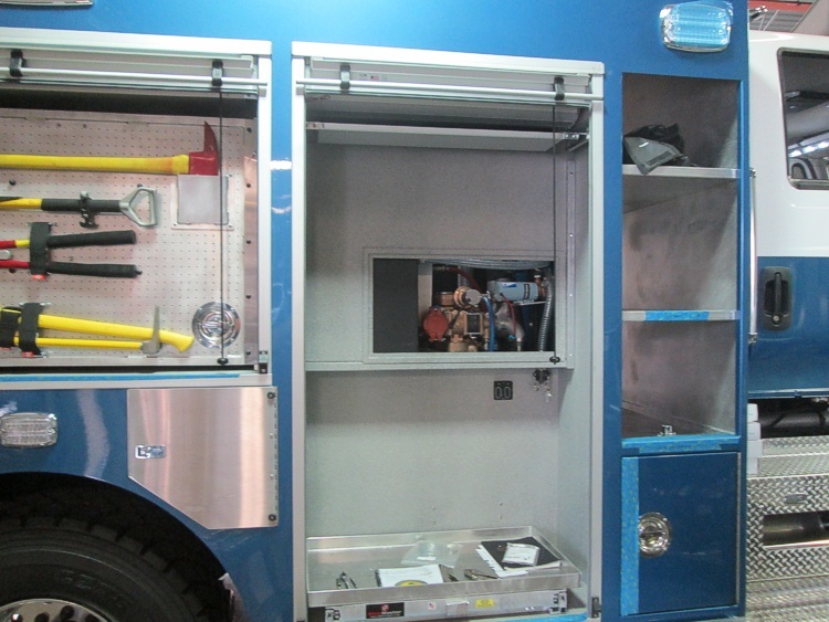

Some updated shots sent from the shop, added shelving, PAC Trac and slide out trays as well as pump panel completed

A few from the visit today

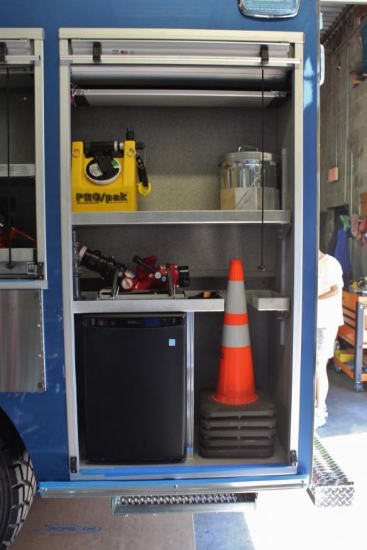

Rear compartment with the pro pack, chimney can, RAM and stacking tips with refrig and cones

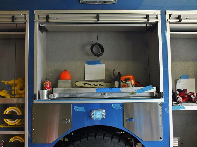

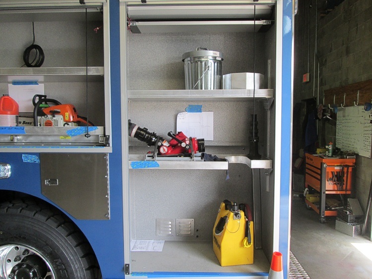

Tilt down shelf with both saws mounted with bar oil and fuel cans as well as the added shelf

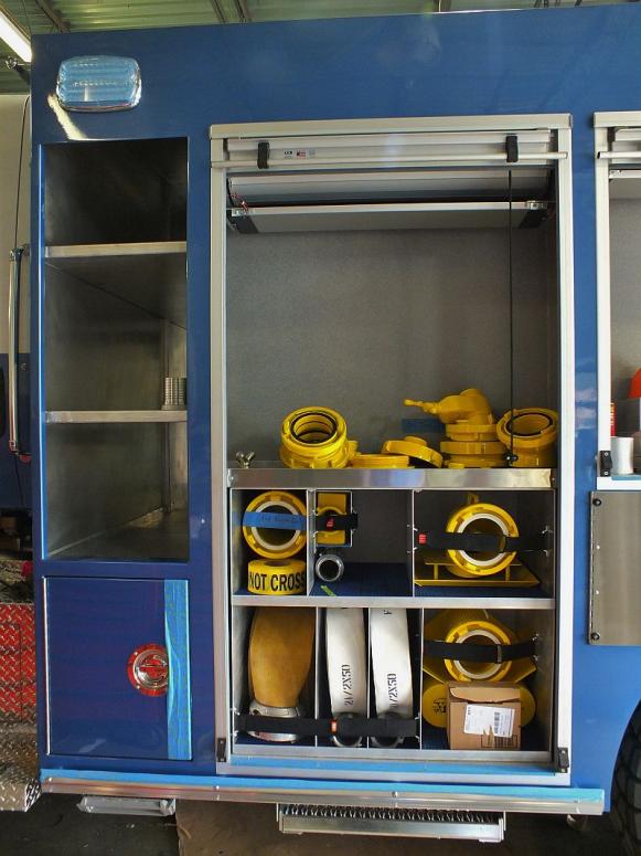

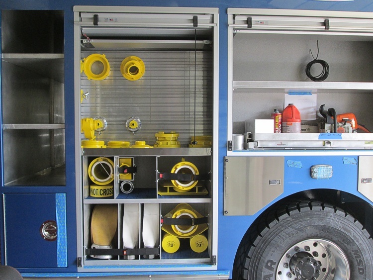

Front compartment, pac trac installed and some of the larger adaptors mounted.

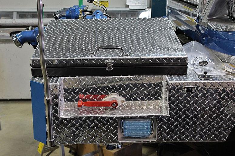

Pump panel cover

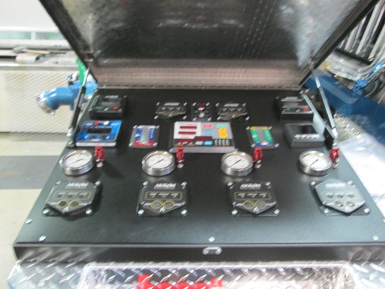

Completed pump panel with dual tank to pumps for the two sumps in the poly tank, red switches are for the individual air controls for the CAFS lines

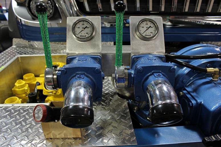

Two front 2 1/2" discharges and gauges
Front bumper compartment with various double females, double males and reducer, hydrant gate, 6" to 4 1/2" mutual aid adaptor for their dry hydrants and the Angus 3 2 1/2" to 5"

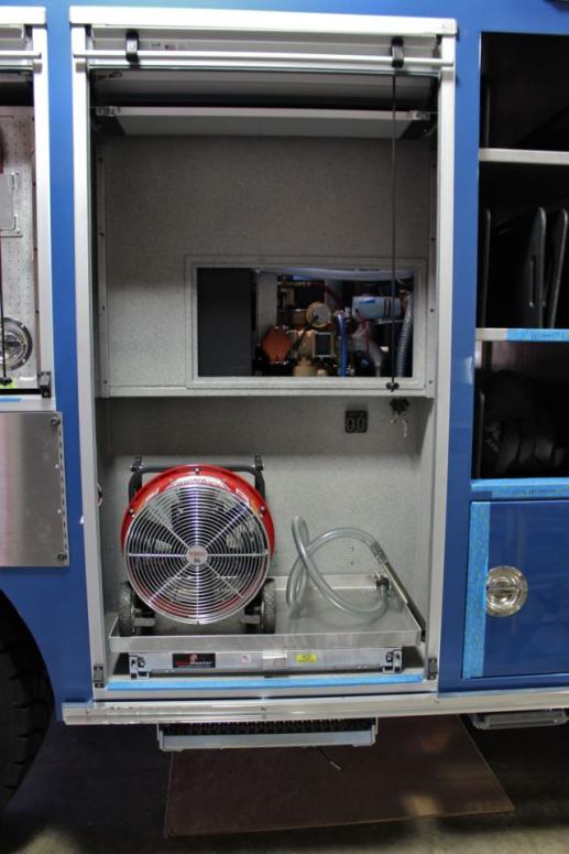

Electric PPV fan, the upper wall will be peg board to hold the various cord and electrical adaptors, a shelf is to be added to hold the cord reels with 10/3 wire on them.

Halogen bulb headlight upgrade from standard sealed beams, what a huge difference!!!, thanks SIGNMAN for the reminder at the last visit.

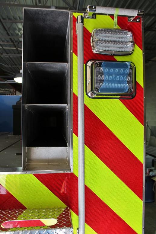

Upper step at rear of Engine that we changed at the last visit to include areas for a gloved hand to be able to grab to use it to help pack hose as well as just a regular step, first photo shows step and second photo shows the grab area cutouts

Very nice. I like how the mirrors are lit up when the headlights are on. Seems like just yesterday you posted the very first pictures, lol.
markmets415 likes this
The amber lights on the mirrors come on with the parking lights, Brendan honestly it's been a long three years on this build and I cannot wait until it is delivered in a few weeks, thanks for the kind words and the posts, they're much appreciated.

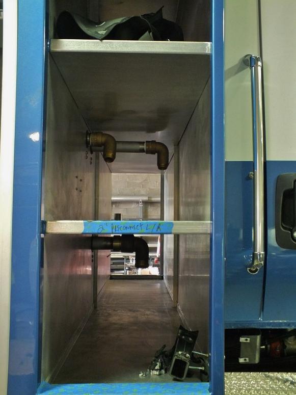

Here is the conceptual layout of the ladder and suction storage area, it will hold a 20' roof ladder, 26' three section extension ladder, a little giant ladder, 10' folding "attic" ladder, three 8' lengths of 2 1/2" suction, 1 10' pike pole, two 8' pike poles and a 8' dry wall hook (there also is a 36" small hook with D-handle on the tool board and on the rear wall of the tool board compartment there is a 4' multi purpose hook), a forestry rake and 3 12' lengths of 6" suction with Storz fittings. The hose bed grating and dividers go on top of this area. So in essence the ladders are stowed horizontally and slide out to the rear of the engine above the booster tank and under the hose bed, allowing a full rescue type body for holding equipment.
Click on link bolded link below, once it opens, go to top of page and click on View, go to Rotate View, slide over to counterclockwise, to view the PDF drawing correctly

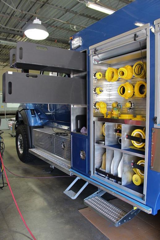

Brought down the air chisel tool and chain saw box for mounting and seeing how the new tarps/salvage covers fit, we actually changed the location of the covers to be in the front passenger's side compartment with the PPV fan, there will on a shelf under the peg board which is shown below.
Most of the large adaptors have been mounted, brought a few more today to complete this compartment and started to label each one, I think the organization of this compartment will be a huge benefit.
A shot looking towards the front with the speed lay trays partial pulled out, top one is for dead lay forestry hose, the center one is for 2 - 2" hose and the lowest one is for 2 1/2" hose

The Scott TIC camera mounted and ready to go

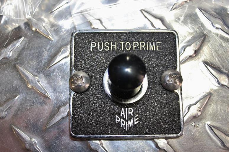

The air primer close up
The air primer back further, it's mounted just to the right of the pump panel

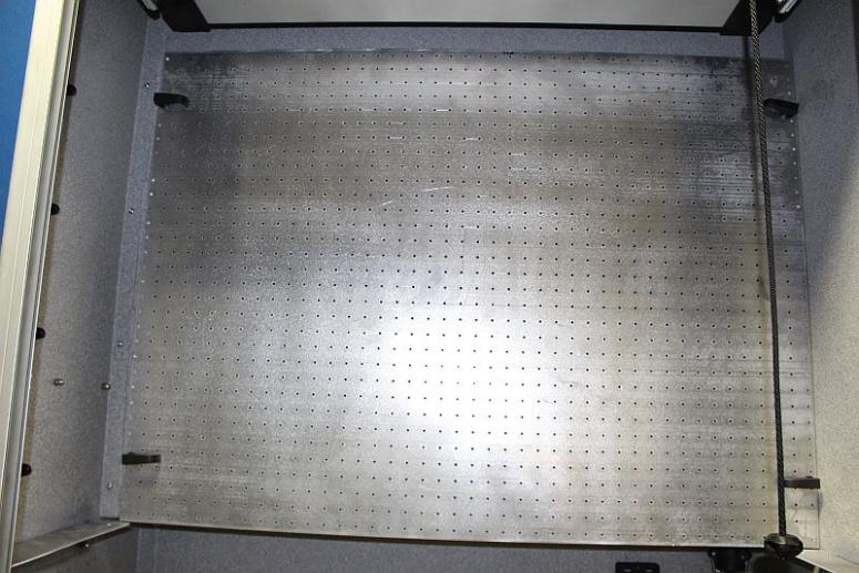

Peg board in the front passenger's side upper area of the compartment, this will hold the various different electrical connections and extension cords, you can see on the side under the peg board the mounts for the tray and in earlier pictures showing the PPV fan on a slide out tray, the tray will also hold two electrical cords reels of 100' of cord.

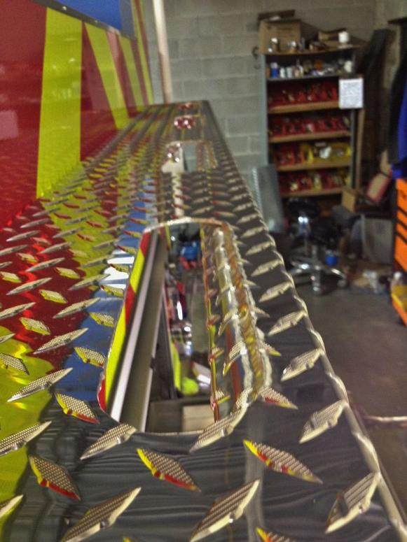

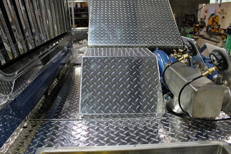

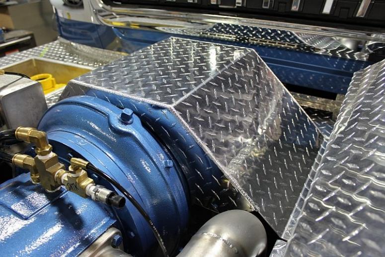

a few more from today showing the diamond plate cover that was fabricated to cover the pump drive shaft and the rear area of the pump
