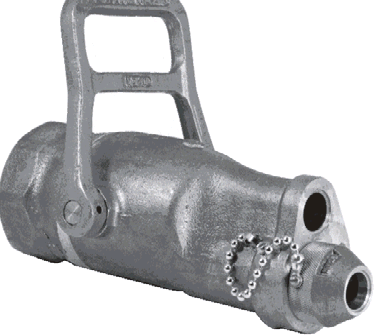

I know the Navy firefighting nozzle commonly used for high-rise fires is called the SG-series nozzle, there are several variations and differences, but here is a picture of one of them.
Also, I'd imagine the 10 companies that carry the nozzle are the "High-Pressure" companies with the 3-stage pumps.
