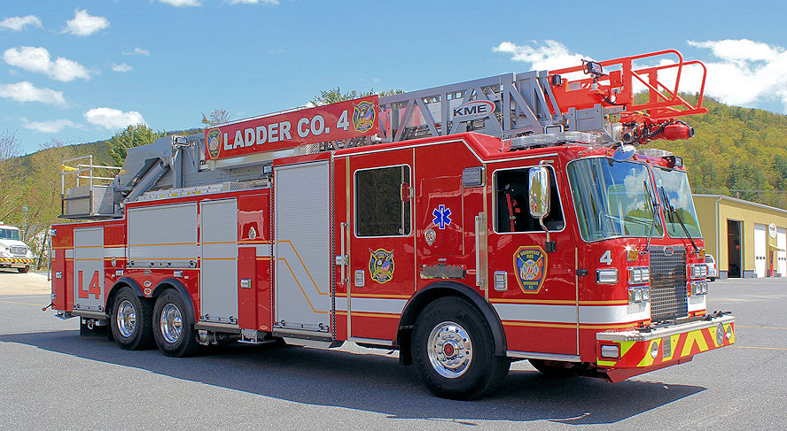

Update: From a reliable (and thanks to) source, the new Ladder 4 will be a KME 109' rearmount Aerialcat straight stick Quint. Delivery mid-2016.
A sneak preview....what an awesome truck! Loving the specs and the new solid red paint scheme!
